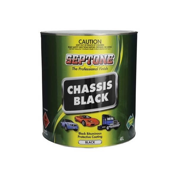

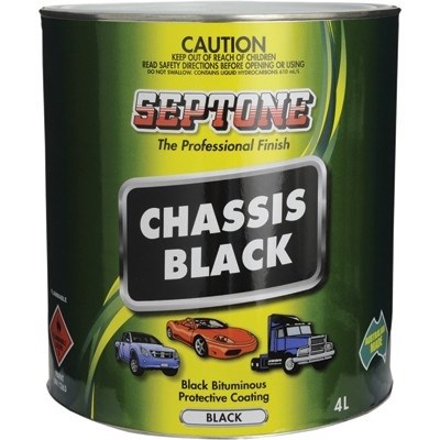

I used some of this from Supercheap to do the chassis and underside of my van:
Chassis Black from Supercheap
AnswerID: 500896
