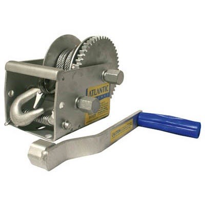

I would in your situation get a boat trailer winch! dig a hole and put some concrete in it, and use that with some reo as an anchor point! then winch your van into position.
All you need is to make a tripod or similar to hold the winch just above the ground so you can wind the handle, tie the back of the winch to the anchor point and an extra lengh of rope to reach the van on the winch cable if required.
I bought a camper trolley but as you say quite a few dollars to invest there.

I can see where a cheap 12v winch (Supercheap Auto) would make life a lot easier getting the van into position but I have to get it back out again and that means a lot of pushing as welll. My other problem would be a hitch point to the van. I think the only spot would be the axle as Adria have a very different chassis set up to Australian made vans. Its just a single Y shaped chassis without the cross members that the Australian vans have. I can't even mount a bumper bar or a bike rack on the back of the van.
I was mainly interested in how far the van would move with each movement of the ratchet handle. If it is only a couple of inches I would be there all day. If it was a foot or so at a time it would make life a lot easier.

Greg,
simple and easy way to move the van. All you need is an anchor point and a detachable bracket so you can move the winch around.
Just use one of these. About $80
