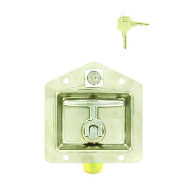

I've got a trailer with a canopy that has four recessed locks with folding handles.
My problem is that one of the handles is so tight to unfold it takes two hands and a lot of strength, (something I lack these days), to open and close.
It looks like a fairly standard type lock with a locking lever sitting between 2 nuts on a threaded bolt connected to the handle, turn the handle and the lever turns etc.
When turning the handle it feels like its binding.
There is a piece that looks like a washer with spokes just above the top nut and hard up against the bottom of the recessed bit below the handle, but when I tap it with a punch and hammer it turns but does not loosen.
If anyone can understand the above and can tell me how to loosen the handle I would really appreciate it.

Is it like this one?
Is it also tight when you've opened the door? Reckon a dose of "snake's pee"(WD-40, or CRC) would do the trick.
If it's only tight when you lock the canopy, then it may need some lubricant on the striker. Such as a teflon grease.
Bob.

Thats the one.
It's tight when I've got the door open and try and close, or lift the handle.
I'll give it the good oil tomorrow morning.
Thank you.
