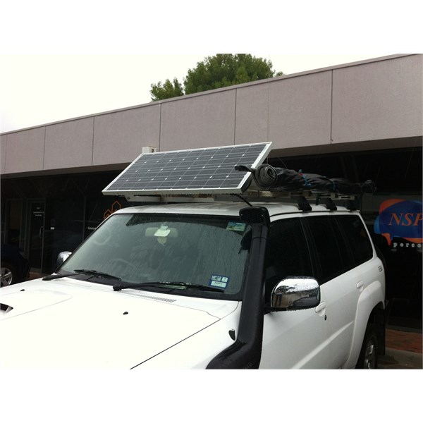

I have bought a few things from Bit_Deals. i have a 95watt panel fixed to my roof rack and it has done a few thousand kilometres no problem. It keeps a 40 litre Engel and an 11 litre waeco running no problems. The covering is polycarbonate so they are light and not too rigid. Hopefully the picture gives you a good indication. No problems so far with stones thrown up.

Hi Grizzle. Can you provide a bit more info about your setup please? Cheers
FollowupID: 782635
Follow Up By: Grizzle - Wednesday, Feb 27, 2013 at 19:01
Pretty basic setup bazooka,
95 watt solar panel wired to a basic 10 amp controller. Probably would have gone for MPPT if I had the choice again.
The trick seems to be to wire the controller as close as possible to the batteries thus avoiding voltage drop. The panel can put up around 22v uncontrolled so if you do happen to lose some volts in the wiring you still have plenty to step down through the controller. I have an Anderson plug close to the panel so I can remove it whenever I want. The wire runs down the inside of the snorkel and into the engine bay via the air box.
The controller is hard wired in my dash. It has a voltage readout as well as LEDs so I can actually see the voltage.
As I said before a very basic setup but all I can tell you is that it works in the real world. I am SURE there are much better set-ups out there and also you must remember people do different things and have different power requirements.
I hope that explains my setup and good luck with yours1
FollowupID: 782638

Thanks muchly Grizzle. Some more food for thought.

Happy to take a couple more pics if necessary
