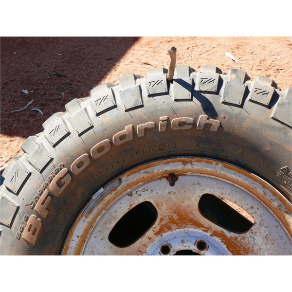

Reply By: Kilcowera Station Stay - Saturday, Mar 30, 2013 at 08:06
We found the Mickey T's wore out very quickly driving around out here on the rocks and gravel roads. Have used mainly BFG's for years with good results. Apart from this puncture on a near new tyre when I was doing a water run on a decent and well travelled station road. Cheers Toni PS might give the Toyos a go one time, seems like they are a good tyre!
