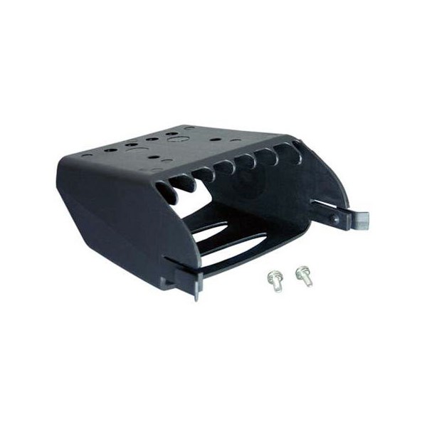

I chose the P2 because it comes with this bracket:
The P3 doesn't have a bracket like this. Using this bracket screwed into the ashtray cavity lets you remove the P2 easily.
By the way, it's OK for the P2 to be mounted horizontally.
