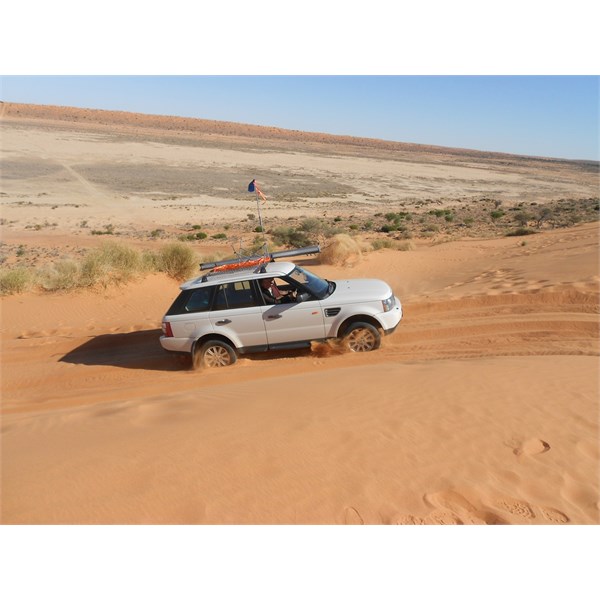

Coming back from the West towards Big Red recently we were swapping places with a TDV6 Range Rover Sport.
As we got to Big Red he was ahead and went up the easier track (but not the chicken track).
To our surprise he bogged down just below the crest.
No big deal everyone stuffs up occasionally.
With the car blocking the track we went straight for steeper track, ran straight up it, spun around on the top positioning ourselves on the crest about 10m from and above the Rover.
I love to see real in the field examples of cars performance and so set we up to watch and record.
Suspecting an issue we also made a quick cup of coffee.
Down it backed and came at it again getting more or less to the same spot.
I had a short talk to them and they seemed aware of the issues and fiddled a bit with
the traction control , dropped of a passenger and went back to give it a third go when I took these photos.
He got no further, I noticed he had good tyres 255 18's and he said they were down.
No doubt dropping tyre pressures would have got him further, but then next time the track may have been steeper.
The key point being that the cars performance was clearly sub-standard and its a powerful torquey expensive machine.
And the owner seemed to know what he was doing.
So why did this happen?
To me there was no obvious issue - I thought these things were well sorted by now and you just turned the knob and it did it all.
(Maybe I have seen to many 4wd ads).

First it was a sensational day to be out their.
In the first photo things are looking good, the tracks relatively smooth.

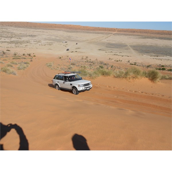

In the second photo, taken just as it was about to stop you can see that the
crest in front of the rear wheel is building up, the front wheels less loaded and tellingly, the sand being thrown back from the front wheel is in bursts - indicative of intermittent loss of traction.
Could be poor suspension control on little moguls or perhaps traction systems braking the wheel.
As the sand looks relatively smooth I suspect traction control.
I do note that in another current thread "Now thats a Surprise" reference to Simpson road test in which the Rovers suspension couldn't handle it.
In this case there was ample time for shock cooling.
After 4 failed attempts we left.
I don't know much about these cars and welcome any comments.
Reply By: Member - Des Lexic - Wednesday, Aug 28, 2013 at 14:50
Robin,
In both photo's the rear wheels appear to digging in more than the front ones. I wonder wether the drive is equally applied to both front and rear wheels. I'm guessing that the rear ones are digging in more and that is why it won't go any further.
The vehicle doesn't appear to be overloaded, nothing on the roof rack and can see through the rear passenger widows.
Perhaps the rear is digging in more because the front wheels have already loosened the track.

Follow Up By: Robin Miller - Wednesday, Aug 28, 2013 at 15:52
Hi Des
Yes the whole car looked pretty good actually and I wonder about equal drive as well.
I guess you can expect some weight bias towards the rear but I all the photo's I took there were no spurts of sand from the rear like there is from the front.

Well first thing you cannot tinker with the traction control.
As I mentioned in the other thread the obvious issue was that the driver had stability control enabled which will not allow the engine to exceed 2700rpm in slippery conditions and may cut power right down.
The RRS would have been easily able to cliimb Big Red if TR (Terrain Response) was set to sand or maybe rock crawl. Sand will bring power on at lower revs and give the TC control a bit more bite so immediately one wheel spins it brakes and drives the other wheels and brings in the center diff lock earlier.
With rock crawl - everything is locked up and closely resembles an older 4wd in 4wd low range and hubs locked.
Also the RRS should have been in Command Shift rather than auto so the required gear can be selected.
Robin - the issue was not the car but the driver. The RRS is just a shorter wheelbase Discovery 3, probably the most capable 4wd wagon off the showroom floor.

Reply By: Rangiephil - Wednesday, Aug 28, 2013 at 15:03
The most likely explanation was provided to you in your previous post by 2 posters who are familiar with RRS's .
Driver training and familiarity with the car's electronics specifically ETC ( Electronic Traction Control)
Also remember that RRS weighs 2.8 tonnes empty and that and 18 inch tyres and a load do not add up to fantastic sand performance at best.

Follow Up By: Rangiephil - Wednesday, Aug 28, 2013 at 15:21
BTW , I meant ESC ( Electronic Stability Control)
Just some more detail. ESC brakes AFAIR the inside wheel and reduces throttle setting when a "yaw" meter tells the computer that the rear is stepping out on a sealed road, so the car is pulled back into line.
When in sand , cars are always swinging side to side so the ESC gets completely confused and brakes one side then the other and cuts the throttle setting, most likely resulting in the car compeletely stopping to the bewilderment of the driver.
Land Rover do know this and there is a disable switch on the dash.
Also the Traction conrtrol will cut in if the ABS sensors sense a difference in wheel speed that indicates that a wheel is spinning. This will happen once you get to a certain point in sand. ( which looks like where the driver is when sand starts being flung from the tyres)
All these things can be overcome by driver input.
1 Turn off ESC
1 Select sand or as the other poster said rock crawl
3 Lower the tyres more
4 Have more momentum. Once ETC starts to operate , then you are pretty near stopping, and may be helped a bit by easing off to equalise wheel speed, but usually better off backing down and attacking with more speed and lower tyre pressures.
FollowupID: 796806

Most definately would have been the ESC (stability control). You have to turn it off or you will have all power cut to the drive wheels right when you need it most. Sand tricks it up very easily and it beats me why Land Rover don't make it auto switch off when sand mode is selected. You have to remember to do it every time you start the car even if you are already in sand mode...the ESC auto switches on with the car and that has caused me grief on a dune or two for being absent minded after admiring a view. Anyone used to a conventional 4wd has initial trouble adapting to the terrain response in Land Rovers. It's a great system but you have to learn how to use it correctly.

I'm sure that the right driving technique can take you further Brett - but from your description its also possible from that the cars are just not up to the job.
If as you say that the "DSC" will cut in anyway, then by definition there is an area between light throttle and "DSC" on that will be to much for the car.
In the cars defense that point might be a hill so bad that no-one could get up it anyway, but also that point might be what we actually observed in this post.
We would all love to hear from the driver (I have rego number) - all I can say is that the car didn't do the job and the driver sounded reasonable and clearly tried different things.

Follow Up By: Robin Miller - Thursday, Aug 29, 2013 at 10:39
Brett all we are taking about here is a car not getting up a hill.
I just put in the photos demonstrating my point.
For your benefit I enclose a photo showing it stopped and just how close it came.
I did not say the cars were not up to the job I said its "Possible they weren't" and we are in a search for answers based on what actually happened.
I appreciate you own such a car , but to get anywhere we need to examine things objectivily .
If I find a problem with a car, then I try hard to seek a solution.
Here we have 3 bits of info ->
1/ The car tried a lot and didn't make it and there is obvious chatter on the front wheels and its digging in.
2/ Other contributers here seem to support ESC as being the culprit .
3/ You have told me the ESC (DSC-I assume its the same thing ?) can automatically switch from off to back on by itself when working hard.
Given the above its a logical deduction that there is a point where things aren't enough.
(Engineers love logical deductions.)
P.S. Your post seems to put the blame on the driver, that may be, but we have no evidence that the car was being thrashed or for that matter that the driver was incompetant.
We should also not forget that he just drove the whole Simpson bar this hill.
FollowupID: 796866
