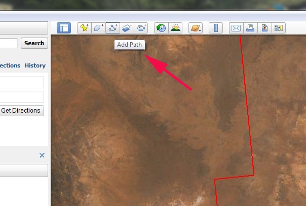

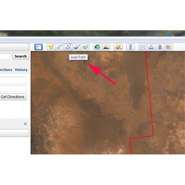

Follow Up By: The Explorer - Saturday, Dec 28, 2013 at 11:56
Hi - you can us the "Add Path" tool to add a line starting and going anywhere (on road, off road, across the ocean).
Click on the "Add Path" Icon and leave the properties box open while making your "path". You can change colour and width to suit under "Style, Color" tab and see length under "Measurements".
Like Google Maps you can't "get directions" automatically to many locations - I assume because the road/track isn't in their database (?) so you have to manually add it. Can get a bit painful for long sections, though depends on how accurate you want your planning to be (i.e. how many points you use to define path).
FollowupID: 805082
