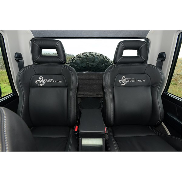

Reply By: Member - Noah273 - Friday, Feb 05, 2016 at 13:04
This is what Multidrive did with their Southern Scorpion 6 wheeler 70 series, road legal as It was listed for sale some months back, not hard to imagine one seat less in the picture. Check the suitability ofParadrive as to child restraints of course.
AnswerID: 595954
Follow Up By: Stephen F2 - Friday, Feb 05, 2016 at 13:11
Thanks Noah273 all not lost then as many people here think impossible but not count my chickens yet.Personally I think my child seat would be a hell of a lot safer in aseat like in your photo ..thanks
FollowupID: 864712
Follow Up By: vk1dx - Friday, Feb 05, 2016 at 13:33
Looks good. This may be your answer Stephen.
If you want to only fit one seat in the back, then you may want to check what the registration and insurance implications are with only three seats in the car, when it is registered as a four or five seater. Just saying that it's only temporarily removed, may not hold any weight with any RTA inspector, the police or insurance assessor.
I would hate to hear that your insurance company dumped your claim because the car wasn't legal. Yeah - that bloody word again, but as a parent . . . . . . etc
FollowupID: 864714
