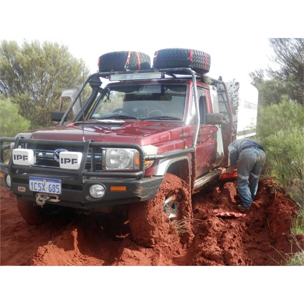

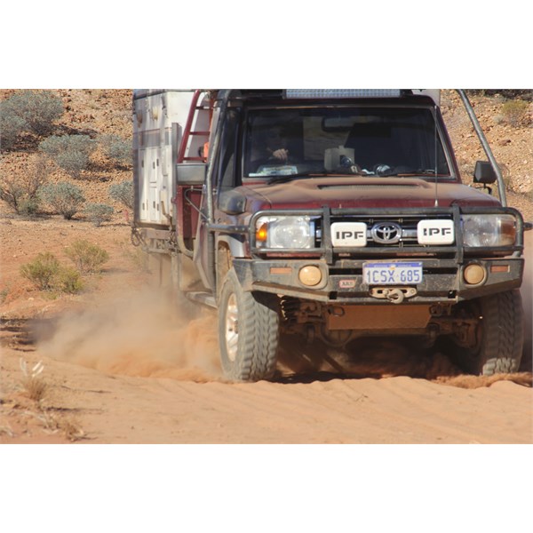

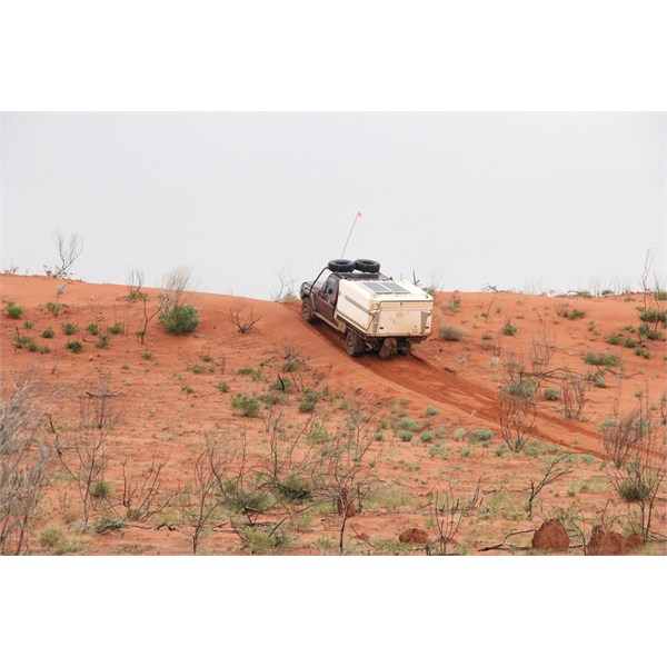

I have had a LC79 since new 2008. Bought just to carry my Travelander. I have been everywhere with no problems. CSR, Steep Point, Anne Beadell, Oodnadatta, Chambers Pillar, GSR, and plenty of remote prospecting in WA.
I first tried the heavy duty leaf spring upgrade. Carried the weight but what a shocker when there is no load.
Now I have Parabolics - best option out. With the heavy duty springs I had air bags to assist lift height a bit and tighten body roll. I have kept them for the same reason but don't need them for any lift. The parablics hold the weight (read overloaded) easily.
I love the travelander for its ease of setting up and well thought out layout. I have seen the current models and I don't like them as much. Some areas have improved and some seem worse. That you will need to judge. The bedding and opening are the same and that is the winner. And the price against what other options offer.
I have found with the travelander and talking to other owners - wherever you are prepared to take your landcruiser the travelander will go. I have been on steep slopes, very soft beaches, boggy tracks all made it through.
