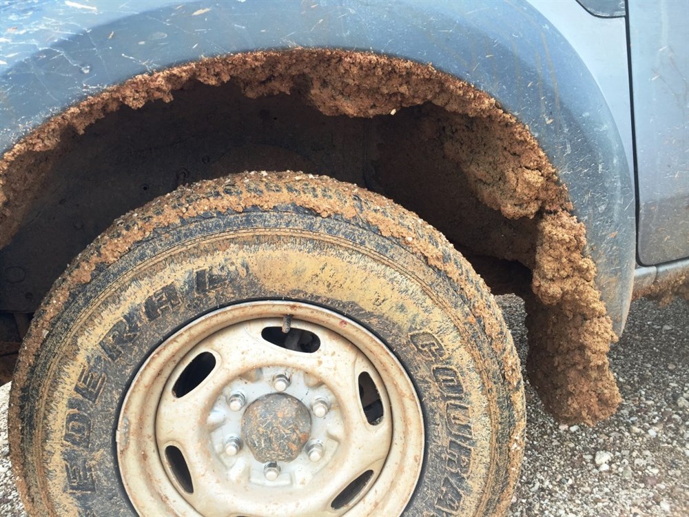

Reply By: Les - PK Ranger - Thursday, Jun 23, 2016 at 22:16
A few pics at Marree . . .
Managed to lose much of the arches stuff on the Hergott Springs drive, but underneath more stubborn.
