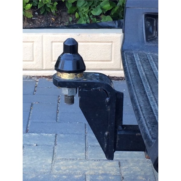

Follow Up By: Nomadic Navara - Thursday, Nov 10, 2016 at 07:57
Have a look at something like this.

Follow Up By: TomH - Sunday, Nov 13, 2016 at 16:11
But if you put a high hitch like the one pictured on a Pajero you wont be able to open the taildoor.
Thats why they sell a riser for the spare, To stop it hitting on a normal height handle on the hitch
