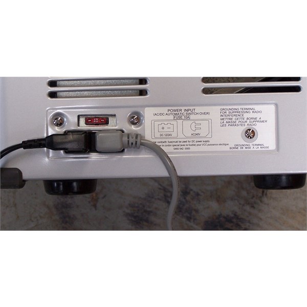

Just wondering if you have checked the 10 amp blade fuse located where the 240 and 12 volt leads plug in, people don't often check that.

Have a good check of the fuse holder as well, if the fuse is OK. A good wack on the plug into the fridge has been known to break the fuse holder.
Iza

Reply By: Tony F8 - Monday, Dec 26, 2016 at 07:25
AnswerID: 606983
Follow Up By: Member - Rustygq - Monday, Dec 26, 2016 at 15:35
thanks Tony, good information, I didnt know there was a fuse there. I have filed that in the memory bank

Follow Up By: Member - Barry P (VIC) - Tuesday, Dec 27, 2016 at 08:59
fuse, to tony thanks it was the fuse as your foto, now running 12 and 240 volt the only other problem it makes a rattle type noise when running,it would keep you awake if it was in your bedroom,i need some ideas what to do about this,do not want to take it to a dealer unless i have to,have rang a engel dealer ,they said i would have to bring it in,could not advise me on the phone thanks again barry
