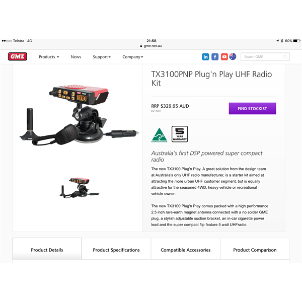

If you just want somethIng for the occasional trip, then this kit from GME is ideal. I fitted one to our Falcon sedan and have talked to truck drivers I work with and they reckon the reception is pretty good. Compact, and it can be fitted/removed in a few minutes.

Was in BCF yesterday and noticed they have this same radio in a different kit. It has a longer aerial, about 6dB(?), and a aerial mounting bracket. Didn't notice any price but no doubt a few dollars dearer than the above.
