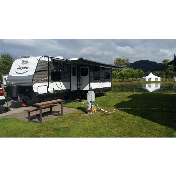

Follow Up By: John G46 - Sunday, Apr 16, 2017 at 09:05
Morning MotherHen,
Thanks for your input.
I/we [being my wife and myself] see the addition of a holding tank just an option.
In your case with an 18 footer you may have a 50 liter holding tank, as in mentioned in my blog, you also should have a cassette/dolly on wheels as part of the package -
Now its your choice if you want to connect the transfer dolly to the holding tank and wheel it to wherever to dump [as you say you do now]
Or... as is allowed in "some parks" connect your holding tank,via the same hose [s] as your light & heavy grey water hose [s] directly to the sewer point at your site.
Or....you can wait until you are moving your van and dump directly to the sewer point in the park, or a council dump point, or if you have the facility at your home.
It just gives you more choice and trust me, on the occasions that your allowed to connect up right at your site its soooow much easier.
Note: The holding tank package normally includes a larger house 3 inches with a "push fit multi hole size discharge end" for a good seal at the dump point [for Black, light & heavy grey water] Plus a cassette/dolly on wheels when you need to empty before you leave the site or if there is no dumping allowed in your sites sewer point.
Because of the tight fitting hoses and chemical treating of the wast water there is no odor - A couple of picks are attached for your convenience
So its all about options - if the extra cost was negligible, there is no down side.
Wishing you and your family a very happy Easter Sunday
Cheers John [& Louise]

Hi John. When we are on holidays, we don’t want added workload of decanting from a toilet fixed tank. :O. Nor do we want bending with bad backs to reach couplings under are caravan.
Yes, a fixed black water tank is an option that may suit some, but I urge readers to consider WEIGHT. In allowing for a full tank of 50 litres, that is up to 50 kilos of cargo you have to forego if you have a standard sort of payload allowance. If you go to a 200 litre tank, that is 200 kilos weight a fill capacity. A standard cassette at maximum holds only 20 litres, but we would be emptying at around half that on most occasions. You state John that you don’t have to travel with it full, but why have one if you do not intend to use it on occasions to its maximum capacity?
In addition to foregoing something from your packing, you also need to consider SPACE for the 50 litre tank. If it means going without a water tank, and you travel in drier and remote areas, the water is more important. You can find somewhere to safely dispose of your black water, but getting clean fresh water may not be as easy.
When we go to CARAVAN PARKS, we usually use their bathrooms, so putting toilet waste into the sullage pit would be a non event. It is also not broken up in a liquid state, as happens with movement when travelling, while you are stationary at a caravan park. The majority of caravan parks we have been to do not have sullage pits on site, but expect you to move your hose around within your site to maintain the grass.
Please read MyBlog on Toilet Chemicals. Most well informed caravanners choose environmentally friendly alternatives so we can dump in connections to septic tanks (as we do at home), or to do no harm if burying in the bush or desert sands.
MyBlog on Self Containment talks about sullage tanks on wheel as per your photo, for use as an option for grey water retaining and disposal. But you need the space to carry it, and if having to decant by car, be able to lift it when full as well as have the space. Finding a suitable place in your car or caravan would be all the harder if filled with toilet waste rather than shower and sink water.
But the most important point I can make is that of WEIGHT. Many caravans still have allowances which were the standard going back to pre-bathroom and caravan water tank days, with single axled caravans having a 300 kilo allowance and 400 for dual axled. Using some of your allowance to be able to carry around a tank full of toilet waste is not an option most would want to choose.
