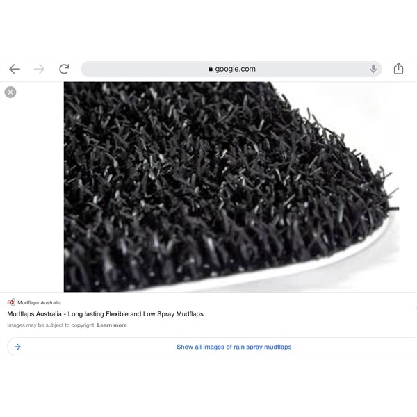

Follow Up By: Bob Y. - Qld - Thursday, Jun 03, 2021 at 12:57
While I devoured my Cup-a-Soup ‘n toast, I found these 3 items that may help the OP.
FollowupID: 914620

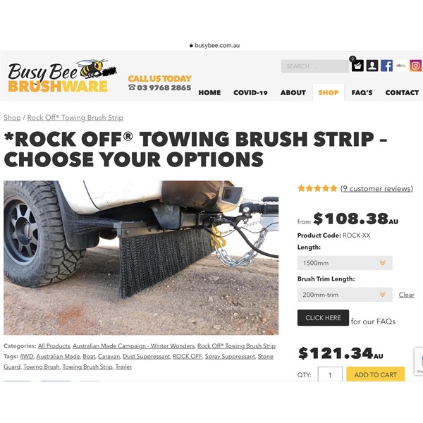

Reply By: Gary T1 - Thursday, Jun 03, 2021 at 15:19
I used this.
https://www.busybee.com.au/product/towing-brush-strip-caravan-stone-guard/
AnswerID: 636659
