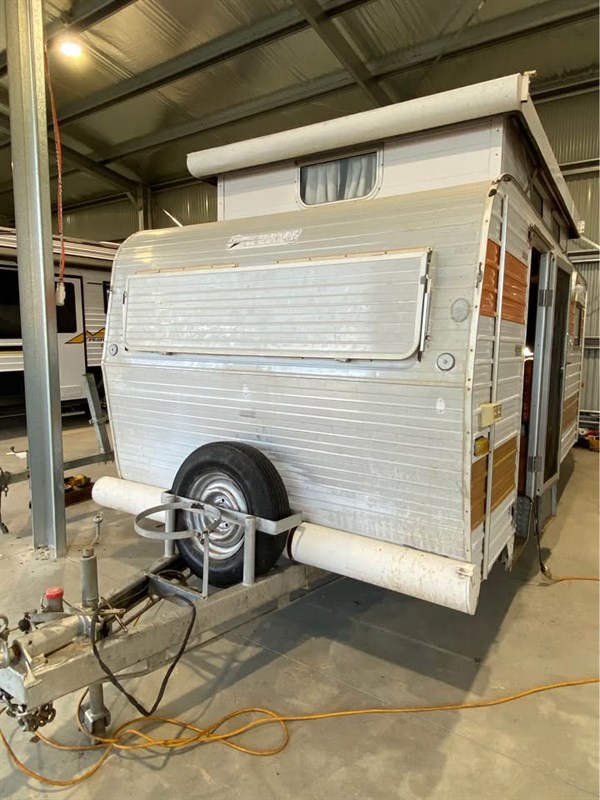

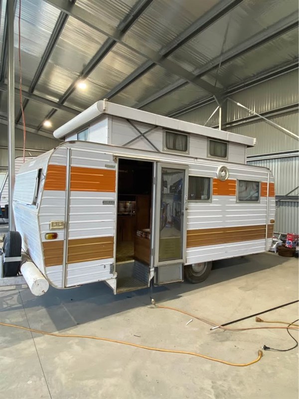

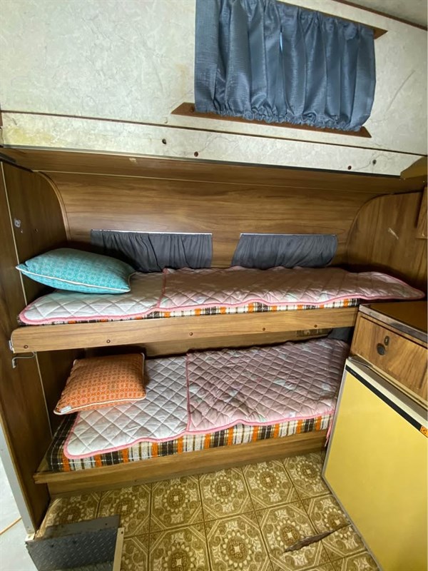

Hi everyone!
First time caravan owner here, and I've just bought a 1978 Franklin Snipe to fix up.
I was wondering if anyone has reno'd one before?
Looking for first timer advice, tips and tricks.
Finding it quite difficult to find any of the Snipe's with the hard side pop top like mine has.
Thanks!

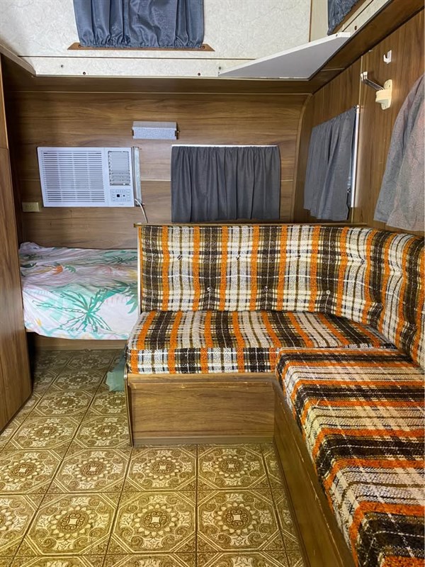

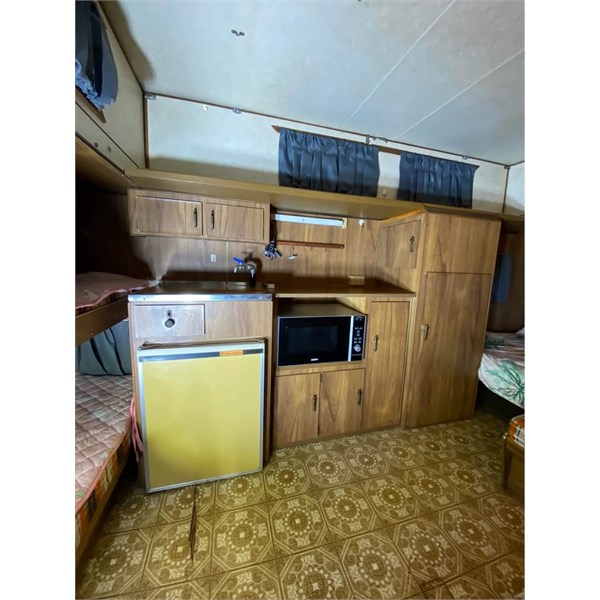

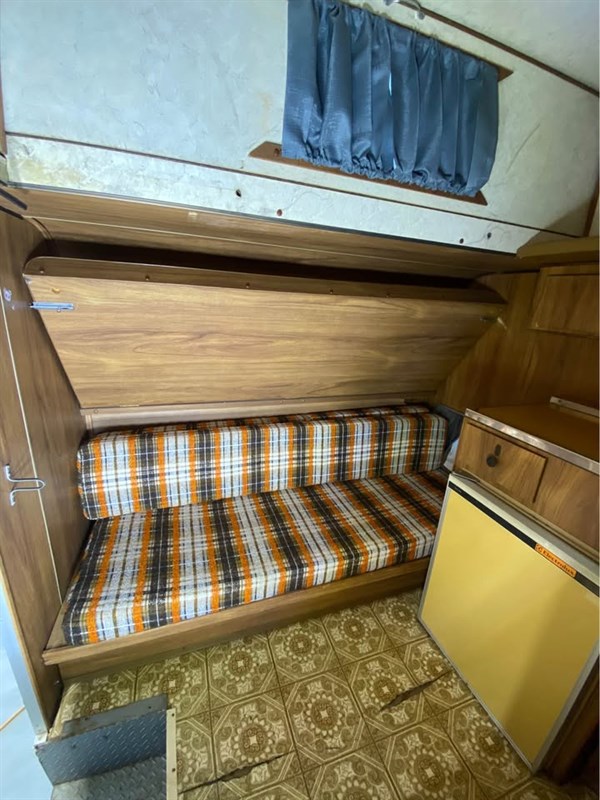

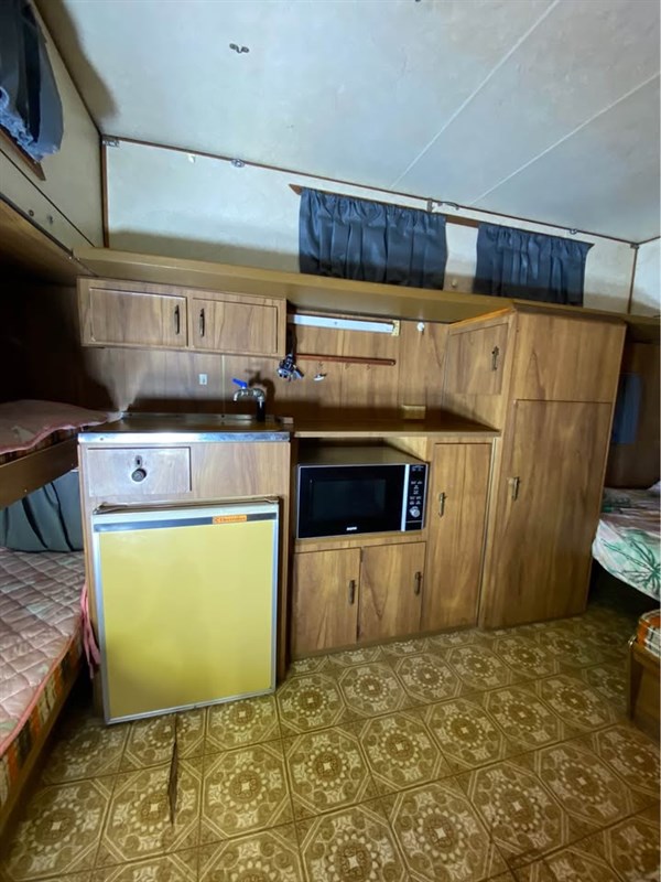

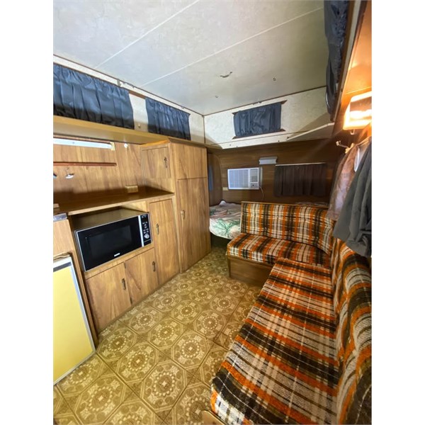

Have never reno'd a van before but I would reckon that the first thing to ensure is that there is no water damage anywhere. If there is then I,d say this is vital to have fixed before contemplating anything else. I think that you-tube would have numerous videos on renovating a van. The decor is that of an older van but if it is clean and functional why try and make it something it is not? Maybe new style covers for the setee, lick of paint on the ceiling and some more modern looking lino on the floor. Maybe some new kick boards around the setee base to match the lino. The van looks in good condition and as it is an older model I wouldn't go overboard in a reno project. LED lights, maybe a portable convection stove top, good water pump and fit Lithium batteries to lower weight and extra power reserves. Solar on the roof. Renew bearings and brakes.Good luck..shouldn,t be a big project but a satisfying one.

You may not have to renew the hubs, but adding electric brakes - yes. In saying add electric brakes, you can add the electric backing plates and retain the over-ride brakes, just connect the existing brake cables to the parking brake mechanism of the new brakes. This will retain the heritage features of the old van. And before I get jumped on by the armchair experts, the dual systems were installed by van manufacturers during the time that manufacturers were going over to fitting electric brakes to all vans. This was done to attract buyers who already towing vans with override brakes to purchase vans and use them without first fitting a brake controller.

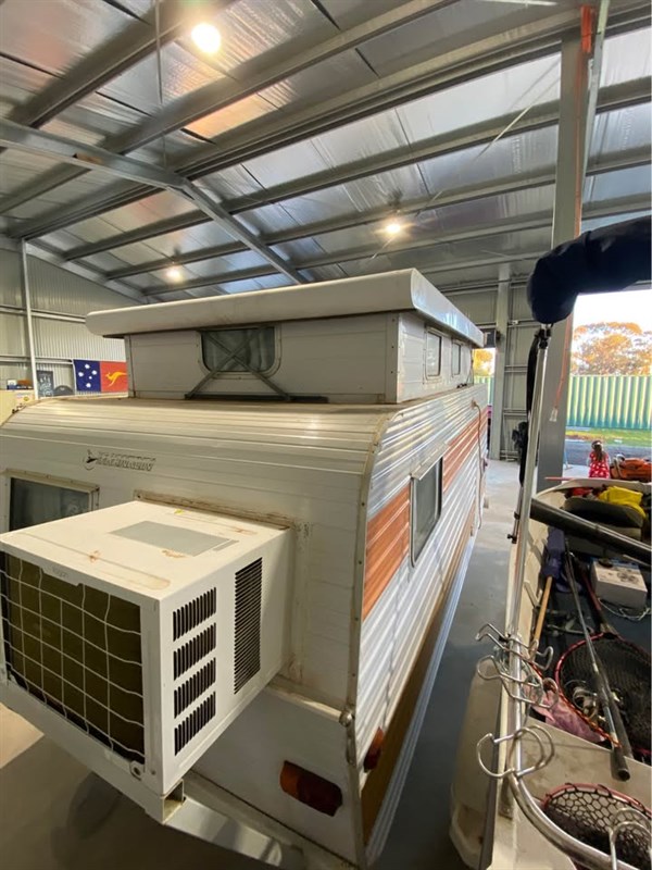

As for replacing the skirt, the van does not have a skirt hanging off the pop-top. It has folding solid walls that fill the void when the top is raised. The solid walls are a much better arrangement than thin curtains. You would have to do considerable work to add the aluminium tracks to secure the curtains, and you would destroy the heritage value of the van.

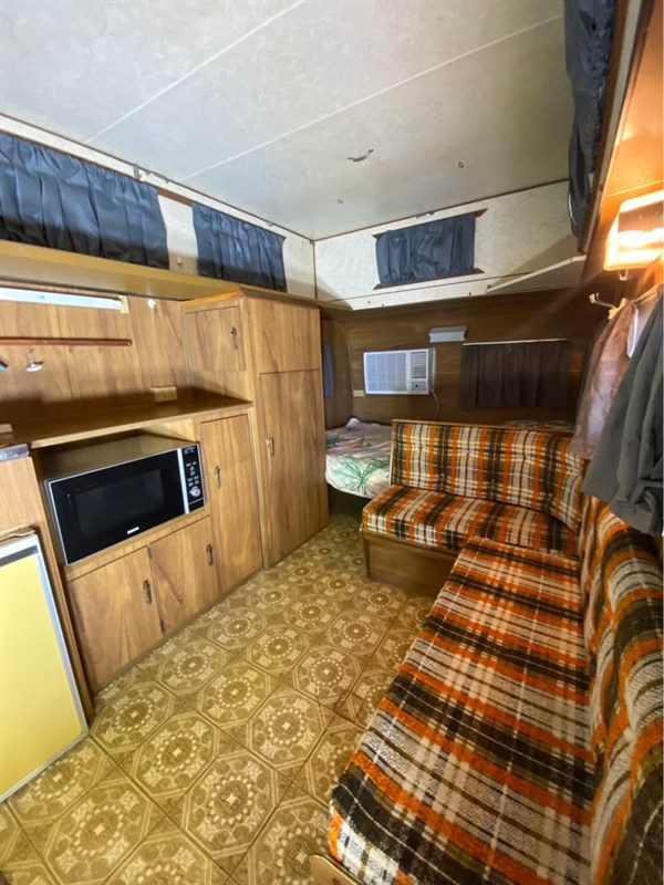

You will have problems if you attempt to radically modernise the interior. I would thoroughly advise you to keep as much of the heritage value of the van as you can. If you decide to sell the van in the future, vintage car owners are frequently looking for a heritage van to tow behind their cars to vintage car rallies. this will ensure you have a ready market waiting for your van.
The side walls of your van, I suspect, will be of foam panel construction. I do not know of any vans of that age that Franklin used framed construction in the side walls. This means that the interior plywood is firmly glued to the foam insulation in the walls, which will make it extremely interesting if you attempt to replace it. Also, the construction of the fixed interior furniture is very lightweight. If you attempt to replace it with furniture with solid construction, you will seriously increase the weight of the van. The axle/wheel assemblies on those old vans is very lightweight so if you add new furniture that does not use the same construction methods, you could have to replace the whole axle assembly.
Changing the interior lighting to LED lights that match the old lighting will not change the heritage value of the van much, as will be replacing the external running lights with LED assemblies. You can still get new glass covers to replace the one on the outside annex light that appears to be missing, You can get LED assemblies to insert in that light.
When you learn to live with the dark colours in the van you will enjoy your heritage van.

Apart from what others have mentioned, If maintaining the LOOK is required then perhaps my suggestions are not what you want, BUT, for ease of wheel changing especially in a challenging situation , while renovating, I would cut a wheel arch to access the wheels. At present you will have to jack it quite high to full spring droop and then fight to get the wheel off.
Also, if possible, fit larger than 13" rims if it has those, because of tyre /load ability and speed rating. A larger modern tyre will cater for highway speeds much better and carry the load with a greater degree of safety.

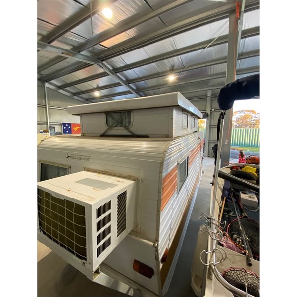

If you are thinking of putting Solar Panels on the roof, be aware that this will add a significant amount of weight to the roof. It will most likely mean that your current scissor lift may not be strong enough to both lift the roof, and hold it in the raised position.
AnswerID: 648261
Follow Up By: Member - Bigfish - Sunday, Jul 13, 2025 at 19:55
There are some very light panels out there that are reasonably light. For example Kickass have one ..KickAss 12V 280W Ultra Slim Fixed Glass Solar Panel...16kg
FollowupID: 929491
Follow Up By: Member - McLaren3030 - Monday, Jul 14, 2025 at 08:36
Yes Bigfish,
And that might just be enough to make both lifting the roof more difficult, and having it not stay up once it is lifted.
It may very well be OK for the first few times the roof is lifted, however, this van and it’s scissor lift is nearly 50 years old, and likely to have some wear in the mechanism. I am merely advising the OP that any extra weight on the roof may compromise the scissor lift.
