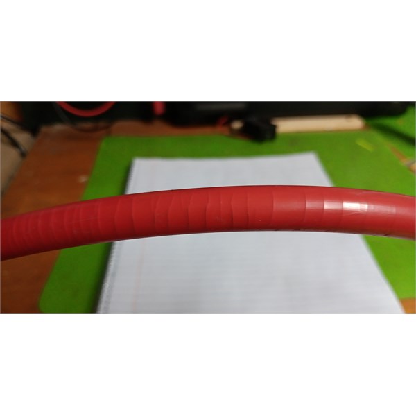

G'day all....some weeks ago I discovered a leak from the hot water pipe in our Jayco Outback poptop....it was under the 'van at the rear nearside corner....it was a tiny hole in the pipe and a squirt was coming out...as it is located behind the wheel I assumed it may have been hit by a stone...we had just returned from a trip out west....today, I noticed another leak!...almost it exactly the same spot....a close inspection showed another squirt....thinking this was quite odd I cut a section from the hose and gave it a close inspection. I was horrified to see that the hose had a multitude of fine cracks!....while there appeared to be only one leak I found that if i bent the hose it simply cracked in two in my hand!
Please refer to the attached photo.
The pop-top is not new, 13 yrs old actually, and we have towed it all over Australia for 58'000 km....however the hose in question has not been exposed to the sun and its security, its connection to the underside, is good.
The hose is typical as used in many caravans these days, I assume produced by John Guest. The blue cold hose, in the same location appears unaffected.
My obvious concern regards other locations of the hose, in many places the hose travels internally in some cupboards and in behind the shower cubical...the two leaks I mention above were relatively easy to get to and repair, I may not be so lucky next time.
Despite being caravanners for many years I have never seen or even heard of this issue before...I would appreciate any comments
Paul....Lockyer Valley Queensland.

I Think you have done well to have the pipes last 13 years, as I had to replace my water lines a couple of years ago so they were a couple of years short of that period and was told by the repairer I was lucky to have them as long as that.
I patched odd section a couple of times along the way.
Would be worth considering replacing they system as you may find the leaks will become more prevalent and probably not at a time convenient to you. Either that or cart some repair kit material with you.

Thank you Phil....your reply agrees with the information I have so far, the constant thermal expansion and contraction being the cause.
And yes I have carried short sections of hose and the necessary fitting's for repairs for some time but never did I realize that some day the entire hot water hose system would need replacing!
While it will be relativity easy to take out much of the old and replace with the new my concern lies with some areas that will not be easy...I speak of course of where the hot water hose runs from under the van and up to the shower....in between the fibre-glass and wall, access to the the hose there may require removal of the shower cubicle, not cheap!
I guess I am fortunate that the issue has been discovered before any major damage has been done.

I was lucky enough to have a vent fitted close to the shower plumbing which allowed access to replace the hot water line. Tight fit but saved major repair job.
Here is another theory - RED is the first colour to fade in paint, perhaps it may apply in plastics as well??

The caravan place I use said that they don't stock it anymore, only blue and black as the red one didn't last

The pipes under my caravan also went brittle after many years. I have a theory, mad or not, that the chemicals in the car exhaust fumes reacted with the plastic pipes over the years as they blow under the caravan. I recently had to replace all the piping.

Mikeee5, I dont believe there are any chemicals in exhaust emission gases that could have an adverse reaction to polymer, and my Triton that the exhaust pipe exit on the off side, the crook hose is on the near side....thank you for your input anyway

There was also a lower quality pipe available that while it looked the same wasn't the same quality as the JG pipe.

There is no guarantee that the hose you have is genuine John Guest.
Even if it is, the standard pipe has limited capability when used for hot water. From memory, 70C is the maximum.
There are other hoses (including John Guest brand) made specifically for hot water use. Same issue applies to the hose fittings.
Most that I have come across (both hose and fittings) are white and they cost quite a bit more than standard cold water versions. They are also stiffer.

Thank you to all who have responded.....as noted it is likely the hose in question is not genuine John Guest. Would Jayco install genuine hose that will at least last the warranty out, or would they install the good stuff?. (A rhetorical question)
Also interesting to hear that the black hose is better. I did think t it amazing that in this, space age, we dont have such hose fit for purpose.
We have been caravanning for over 45 years and this is the first time I have come across this issue, we have had seven caravans but sadly, in hindsight, this one is our first with a hot water system...lol

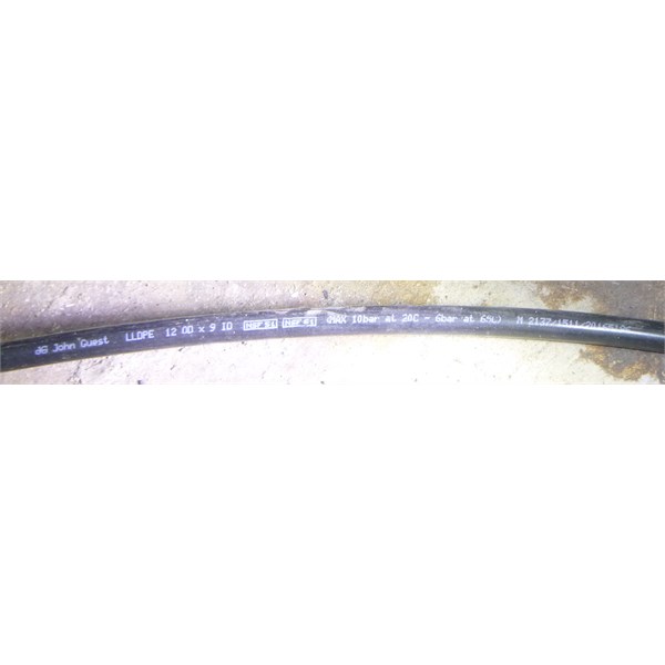

John Guest tubing is LLDPE (Linear low-density polyethylene) which is more durable than some other polymers. It is available in several colours but only the black is UV stabilised, red being the colour most affected by UV.
It could be possible that some manufacturers (China?) may use the slightly cheaper and weaker LDPE polymer.
Although your problem tubing is under the van it may receive some (15%) UV reflected from the pavement. 13 years of exposure could be enough to produce failure. Is your point of tubing failure close to the side of the van?
In general, it is better to use all black tubing. After all, it is not difficult to differentiate hot & cold pipes when installing by wrapping a little red PVC tape near the ends.
As to replacement of installed tubes, in most cases it is possible to securely connect the end of a new tube to the old tube and use the old tube to draw the new tube in without having to dismantle cupboards or wall sheeting.

This morning I spent some time under the van, flashlight in hand.
The cold hoses are black in color, not blue as I may have said. The hot water, where it enters and exits the HWS (Suburban) is white..under the van the white hose becomes red.
Once my initial shock, where my first thoughts were to simply sell it for whatever I could has passed I have been looking at the practicalities...as I mentioned my biggest fear was should the damage that would result if a leak developed behind a wall, or worse between the wall and the shower cubicle...looking today I see that the shower combination tap actually sits on a panel about 200 x 100 mm and held there by four screws, I am sure that once that panel is removed I would have a chance of feeding new hose up from under the floor which is directly below and only around one meter away.
Having said all that I did go over the underfloor red hose, from the HWS all the way to the rear and I was unable to find any of the cracking visible in my photo. The cracking seems to be restricted to a shortish section...maybe 2 meters in length as it runs across and secured to a chassis rail and between to John Guest connectors.
The ensuite hand basin combo tap, and the galley sink both have short lengths of the red hose coming up from the floor and connected to typical reinforced flexible hoses, they too should be easy to replace the red hose.
I note too that the little red clips that secure the John Guest connectors, designed to prevent inadvertent disconnection, despite costin a few cents each are not present anywhere in this Jayco...I am very aware of the strange things that vibrations can do, especially on Western Queensland corrugations!

You say…."The cracking seems to be restricted to a shortish section...maybe 2 meters in length as it runs across and secured to a chassis rail and between to John Guest connectors."
Could it be that hose has been replaced at some time and an inferior grade product fitted? If so then simply replacing it with quality LLDPE black hose may be your solution.

Allan, thank you for that....it is possible that the 2m section of hose may have been replaced at some stage....and, as I said, today I have been over the red hose, where I could access it throughout the van and did not find any evidence of the cracking as seen in my photo, if present it would have been readily felt.
Today I replaced the damaged section and I pressure tested the van for most of the day, firstly by running the Shurflo 12VDC pump...as you would know the pump will shut off once the internal water pressure reaches a pre-set number, I think perhaps 40 PSI...at that point I left the pump energised for about 3 hours, listening carefully for any tell-tale pump noises, and checking for any leaks, I heard and found nothing.
I then turned the pump off for another 4 hours after which I reenergised it and was happy to hear no pumping action, the pressure had been retained..from this I concluded the entire water system to be sound. Would you agree?
At this point in time we think we will take no further action but going forward our plan is to always ensure the water pump is turned off after use, something we generally do anyway, in addition we will remember to turn off the shore mains supply should we be in a caravan park and go away from the caravan.

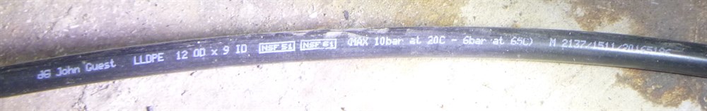

Follow Up By: Peter_n_Margaret - Wednesday, May 20, 2026 at 11:40
I think it says...JG John Guest LLDPE 12 OD x 9 ID {NSF 51] [NSF 61] (MAX 10bar at 20C - 6bar at 65C) M2137/1511/20165196
Be aware though that the printing does not seem to be very durable. I could not find any printing on hoses assembled to my vehicle, despite it coming from the same source as hose that was printed, but not installed.
The printing on red JG hose is similar.
JG also supply PEX hose and fittings designed specifically for hot water applications. They are white in colour and significantly more expensive.
