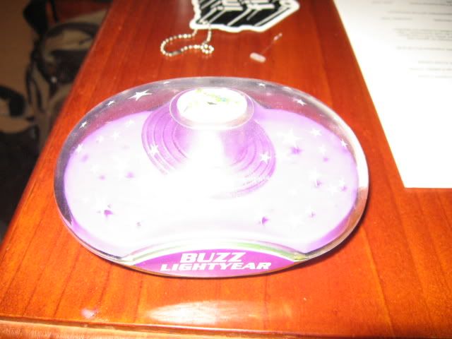

Reply By: Member - shad D (NSW) - Monday, Jul 24, 2006 at 20:39
hi brewman,
in our camper for our kids they have a buzz lightyear night light that uses 2xaa batteries,we bought it from coles and it works great.
shad..

Follow Up By: Brew69(SA) - Monday, Jul 24, 2006 at 21:42
Hmmmm......Brew wakes up all ready for action and finds Buzz in his bed. HAHAHAHA

ahhaha buzz lightyear night light.....
i think i might know the one you mean....
its not mine....i swear!
they do work a treat, come in cindarella and winnie the pooh, available from coles and bi-lo supermarkets,
but also you can buy the camping night lights, theyre usually $15-$20 at Kmart, BigW and the like and are usually magnetic also so no mounting is needed and run off 2 to 4 AA batteries
dean
