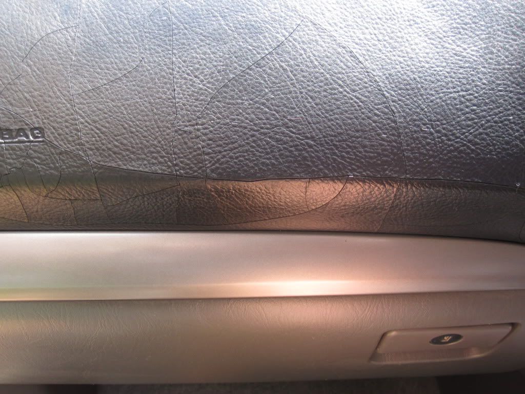

Have any of you had top replace the dash in your vehicle? From 2003 onwards they develop small cracks in the material.
I am having a discussion with Mr Toyo at the moment and would appreciate knowing if this is a large problem.

Follow Up By: Kimba10 - Wednesday, Nov 02, 2011 at 13:00
Hi Bill, yes its a huge issue with the 120 prados, Doesnt seem to matter when the vehicle was built, wether its been in the sun or not, armouralled, etc some crack some dont. At the moment mine is ok. I would be using the info supplied on the pradopoint website (which Im a member of) and start getting the old printer loaded up with some ink and plenty of paper, and take along with you to Mr Toyota, some dealers are replacing at full cost to the dealer. some are charging half half, others $1500 for the dash pad and you pay labour etc so worth reading all the pages and getting the write info to print up. Some of the vehicle have huge klms some have very little, they range from the GX to the Grande.......good luck

[imghttp://i1019.photobucket.com/albums/af314/hsv1968/lukey2830dash7.jpg[/img]
Some are worse then this which is hard to believe and this bloke also had a dash mat fitted from new so makes you wonder what the hell is causing it ???

Follow Up By: Member - bbuzz (NSW) - Thursday, Nov 03, 2011 at 08:27
Geez! They are horrible.
Mine are not that bad ...yet. But I have cracks in all the same places.
Thanks for posting the pics. I will use them as an example of where mine may be going.
I cannot for the life of me see why a recall hasn't been issued. If for no other reason than the cracks over the passenger airbag must be a danger if the bag goes off. There will be bits of plastic breaking off everywhere.
