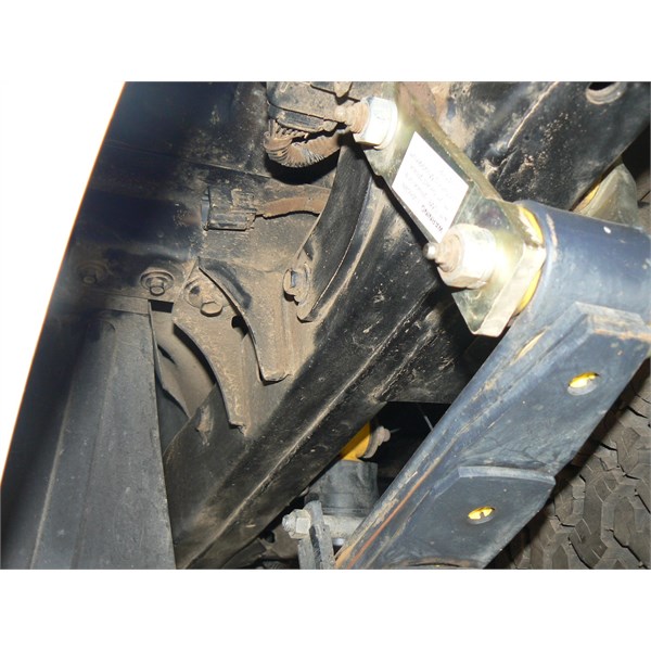

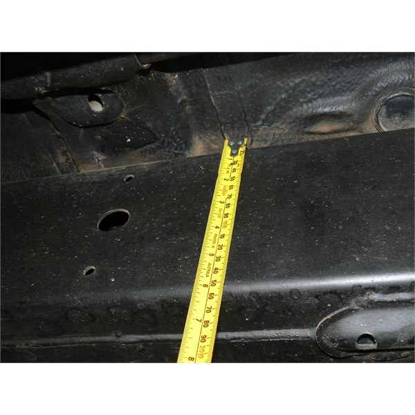

I have just taken photos of the chassis.
It ranges from 150mm deep down to 90mm deep, 80mm wide where it it double plated to 5mm thick, then progressive getting wider to 130mm where it is 3mm thick.
That isn't a weak chassis by any means. The old rangers/bt50's had very small thin chassis's compared to the new ones. Had a look and can't find one reference to a bent chassis on a PX ranger
The chassis is 1mm thicker than a cruiser in the rear.
like I said, if that was a new Ranger/bt50 then the owner abused it to the max.

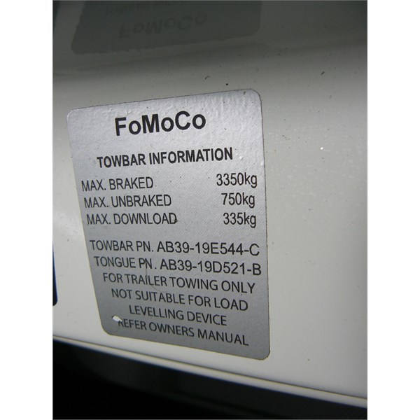

What is the ball weight limit for this vehicle?
FollowupID: 798381

Frank P, I read online the max ball weight is 335kg??
Does that sound right to you?
FollowupID: 798383
Follow Up By: Milz - Friday, Sep 20, 2013 at 20:50
Apparently it varies between variants.

just another thing to look out for. The genuine ford tow bar states not to use a wdh.
I towed the full trip with no wdh and the van very, very stable. I used a wdh on my other vehicle with the same van and it pitched a lot on bad bitumen roads.
Here is the photo of the placard.
Just on the spring side of things. I upgraded to 300kg springs with a 50mm lift. The Ranger weighs 2680kg with rear draws, full 130l fuel tank, rear mounted second battery and the drop down fridge slide. So even running empty there is a fair load in the back.
The springs have a good progressive secondary spring rate and the load goes right where it should go, and that is on the spring hangers.
The original springs are a little soft, as they give occupants a good ride. They just don't cut it when loaded.
Although wdh's are touted as levelling devises, they are in for spreading some of the weight onto the front axle, to make the vehicle more stable.
Re. The broken chassis problems, this new vehicle does have a much improved chassis. If underground miners haven't broken one yet on a dual cab, they must be good.It is nothing to have 4 rockapes in a dual cab with a pallet of cement on the back. The decline roads are good but once into the orebodies things deteriorate to bone jarring.

A lot more people would have a lot less trouble if they paid attention to placards like that and took advantage of the manufacturer's customer information service. The moment you start getting up near the maximum for anything, things start getting critical and you have to know exactly what you are doing.. That is where road surfaces and trailer/van design and size come into it and restrictions apply. A manufacturer will specify a maximum carrying and towing capacity but they don't claim the vehicle will carry that weight anywhere or tow anything that happens to weigh that much in any conditions. The Ranger may be able to tow 3350 kg but lets see it do it over the Simpson. That is just one restriction and there are plenty more as there is with all other makes.
Be careful with excess weights and heavier springs. The car still has the stock chassis, axle housing, wheel studs and wheel bearings. Have a look at the photos in the vehicle breakdown section in the photo gallery on the Mt Dare hotel web site. There is a cracked diff housing, a broken in half diff housing, a broken torsion bar arm and a rear coil spring mount ripped off the chgassis. No doubt the heavier aftermarket springs came through wthout a scratch.

Wounder how many other vehicles are not meant to have load leveling devices fitted.
Or it may have something to do with the anti trailer sway.
FollowupID: 798457

coolone,
not to sure, but I would suspect the sway control would have something to do with it.
