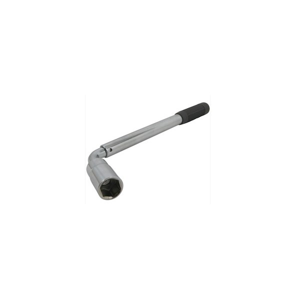

Follow Up By: Allan B (Member, SunCoast) - Wednesday, Nov 07, 2012 at 17:00
Hi Bazooka,
My breaker bar/wheel brace is telescopic, 500mm long when extended.
It is a solid type, without a swivelling joint for the socket. This type does not allow the socket to twist off line and provides handle offset to clear the rim & tyre.
Mine came with the vehicle. Not easy to find on the web but here is a reference to a source.
My torque wrench is 400mm long. I prefer not to use it to undo wheel nuts, only to torque-up.
My wheel studs & nuts are always lubricated with Loctite Antisieze to ensure torque accuracy and ease of removal.

Follow Up By: Bazooka - Wednesday, Nov 07, 2012 at 17:27
Thanks chaps. Plenty of choices. I usually just give my nuts a squirt with WD40 but I'll have a look at the Loctite.
