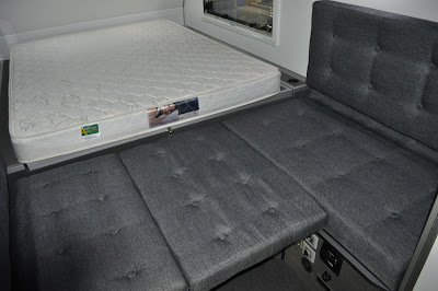

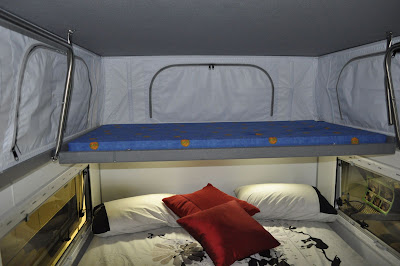

Hi Browny,
Actually they can sleep 5. And I also have a 4 bike carrier on the front too (thats what the front "flap" folds done for). I have the optional single bunk bed (can be 2) and the table also converts to a bed so mine is set up for my family of 4. Yes, it is on the tight side but hey, the van is only for sleeping in IMHO. I did look at the KK and in previous models they too had an internal kids bed option, but now they only have an external "tent" that goes under the slideout bed on the outside - didn't suit my 2 kids. Also, the KK has an internal kitchen, something I specifically didn't want - been there done that.
And I don't know if you have ever tried to look at or buy a KK, they would have to be the most arrogant people I have ever come across. The KK was high on my list and I was glad to be able to cross it off, the attitude of the sales people and also the attitude of KK after purchase (read on forums) would have been enough to cross it off my list anyway.
Kids dinette bed
Kids bunk bed (can also get a double bunk)
The Quantum is not for everyone, but it certainly is for me. I am lucky enough to be able to get what I want and this was chosen on what I thought would suit me and my family best and where I like to travel.
